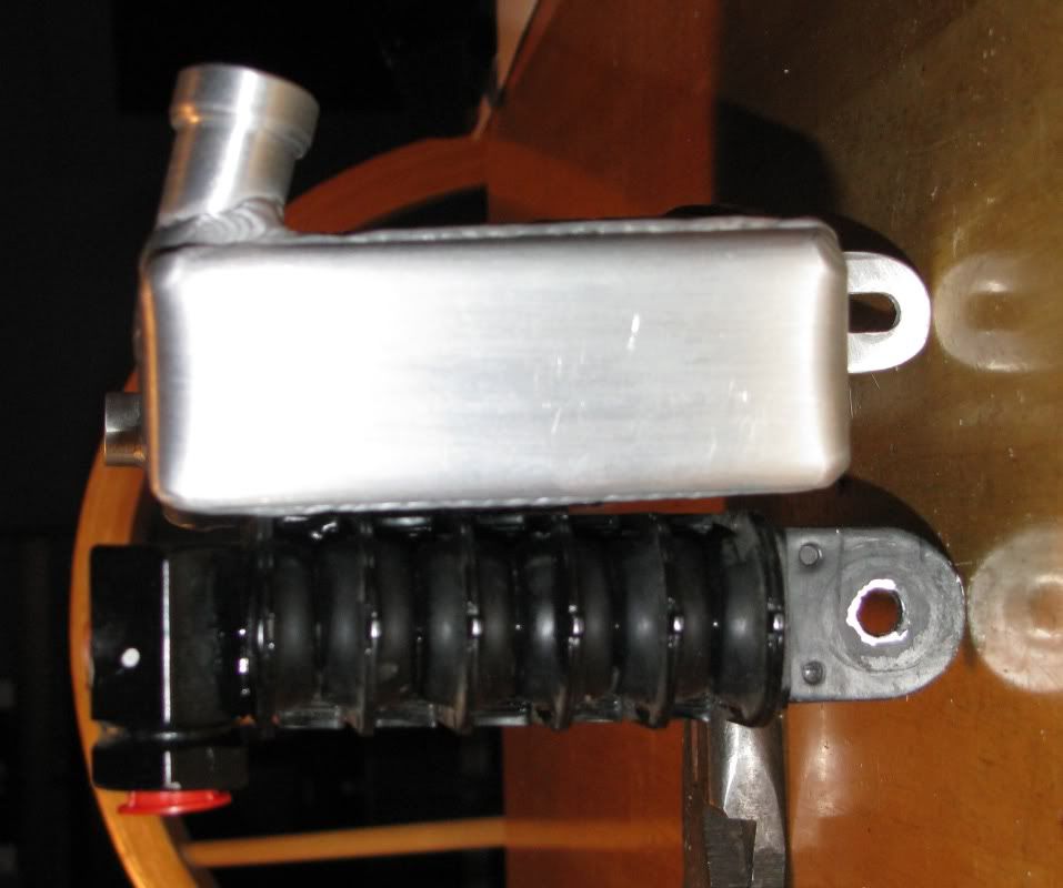

I've got a HM cooler now - it was said to improve cooling - does it?
The size is 225 x 80 mm (didn't measure depth)
Is that larger than stock S2R coolers?
[moto]
issss bigger than the old school box oil coolers like on me 900's
By chance, could you measure the distance between the two mount tabs?
BK_856er
Stock is 225x75x35mm with 6 rows.
It's the black that affords better cooling... 8)
BK

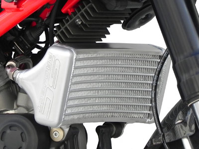

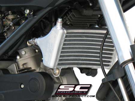

Febur oversized oil cooler for  Hypermotard (came out before the EVO):
NCR oversized oil cooler for Hypermotard (via Desmoworks):
SC-Project Hypermotard Oversize Oil Cooler (via Motovation):
