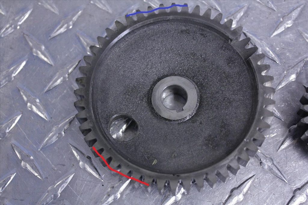

My theory is:
Channel 1 and Channel 2 are tooth counts.
Based on my estimations, one or both of them is set wrong.
Click the drop down that says "Ducati fuel inj 48-2" and select "Ducati fuel inj 48-2" and click yes when it asks if you want default settings.
I'll have to go double check on a bike in the shed or the other PC... If my theory is correct, base should be the tooth at TDC or the next tooth ATDC, channel 1 is for Cylinder 1, channel 2 is for Cylinder 2.  Max is the maximum teeth advance, and works out to 60 crank degrees... which is pretty standard for electronic trickery.
It doesn't run right at ignitech's settings because their tooth count is off, and it doesn't start at your settings because you are even farther off and backwards.

Alternatively, you can check yourself by doing the following:
Remove spark plugs.
Remove cam sensor.
Rotate engine by hand until you see the recessed gear teeth.
Count the teeth until the first cylinder gets to TDC.
Count the teeth until the second cylinder gets to TDC.
This is how ignitech has it set (red for channel 1, blue for channel 2).

Dirty Duc
Quote from: Dirty Duc on August 08, 2015, 10:31:29 AM
Remove spark plugs.
Remove cam sensor.
Do this.
Ignitech may number the teeth 0-45 or 1-46 so you will have to try it both ways.  In the picture above, I numbered them 1-46.
I don't remember how you chose to connect the coils... the wire designated 1 should correspond to channel 1.  Whichever cylinder that is gets numbered the same as the tooth count in the middle of the window for "Start advance."  Subtract 5 and that is "Max advance."  Repeat for channel 2.
