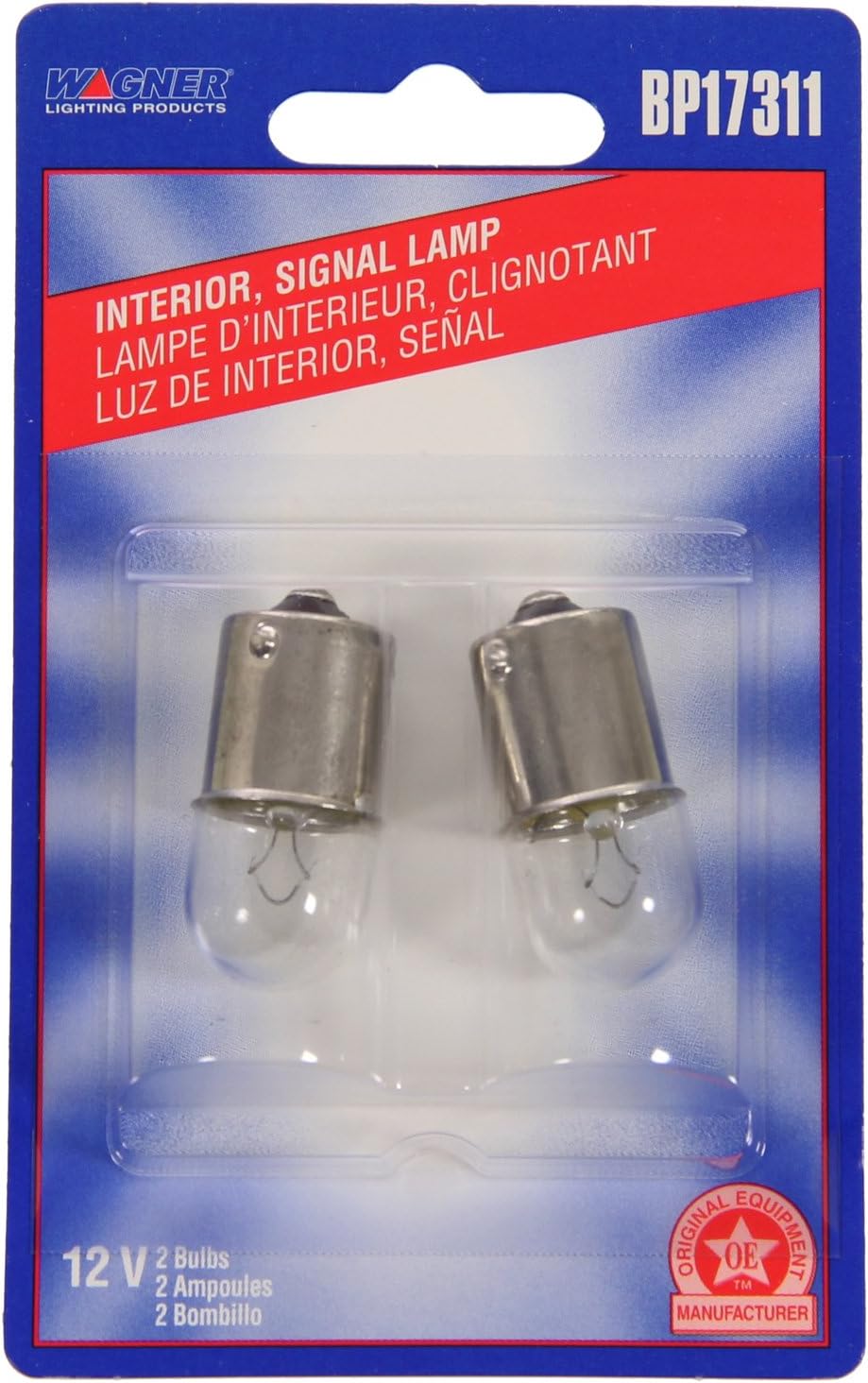

What bulb(s) to get
The part # of automotive light bulbs are confusing, if you haven't been playing with them for long time.
So, let me explain quickly.
First, the base type.
For these Monster turn signals (2002-2008 ish), what you need to look at is...
Anything that says BA15S has the right base.
BA means Bayonet base, you push and twist to remove / install.
15 means 15 mm diameter base,
S means single contact
However, 1156, 1157 bulbs, for instance, have BA15S base, but the heads are too big.
This is important, because the turn signal bulb has to fit into the very confined space.
If you want to get this done quickly, go to NAPA and get this one.
https://www.napaonline.com/en/p/LMA17311
Or, Amazon Prime
https://www.amazon.com/Wagner-Lighting-BP17311-Miniature-Bulb/dp/B000C902KM
They are the same thing.
S21FOLGORE
Forgot to tell you this.
To remove the light bulb, try to push it into the socket.
If it's reluctant to move, try a couple of times.
If you can feel the movement of the bulb, simply push it in and twist.
There may be come corrosion, they may be just lightly stuck.
As for LED bulbs and LED turn signals, follow the advice above.
You are not going to gain anything, you are not going to improve anything by switching to LED bulbs.
Just ordering the bulbs on Amazon Prime, or go to NAPA and get them is A WHOLE LOT EASIER and ,
most importantly, IT WORKS.
Way better than adding register to your circuit and do all extra work.

MsTek
Thanks!
I just ordered it off Amazon.  I'll try again this week to try to get the bulb out.  I was shocked that neither the automotive guy nor I could do it. We were so scared to break it!
