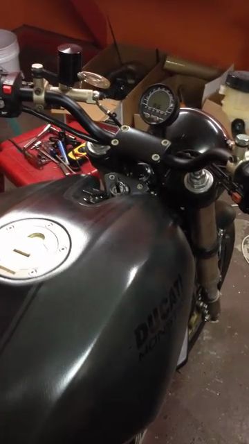

Here's a video I took of how it's running. Hopefully you guys can hear it alright over the plates.

Was the bike started cold with no squirts of the accelerator pump, or was it warm already? If that motor was cold, then it started way too easy (even more so if it's cold there and you didn't prime with the accelerator pumps). That would mean too fat slow jets. If the motor was warm then disregard that.
Sounded pretty normal at idle. Couldn't judge at higher revs due to the clutch clatter. [evil] The sound may be clearer on others' computers.
